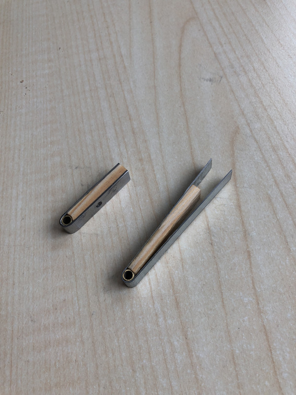

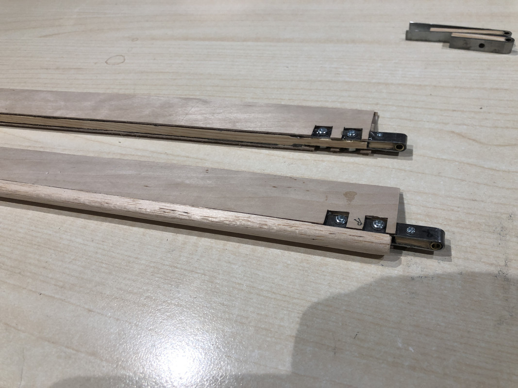

Man, why do I do things so complicated :oops: I just finished these, wondering about the best approach..
First I bend some test strips:
Which later turned out to these:
I did reenforce both with a carbon strip, but now I'm considering to make new ones as yes, they look stronger made out of one piece! :D
Thanks a lot!!

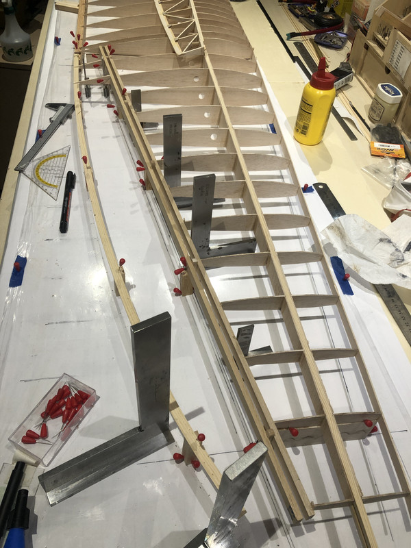

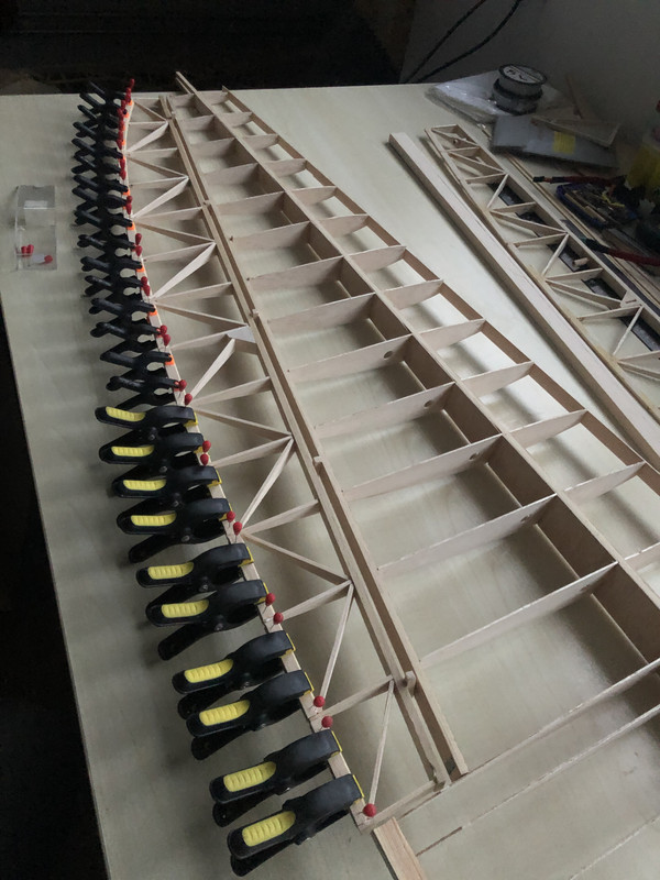

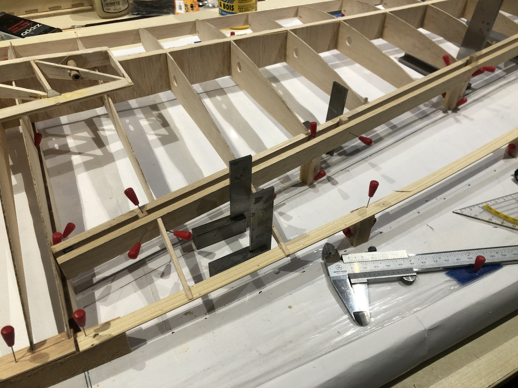

So as suggested I flipped the plan and got on with it ;) ;
I have to cheat every ones in a while with filler;
It almost starts to look like a wing :D :
