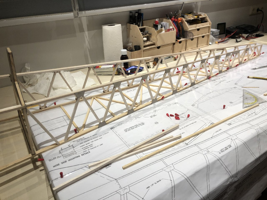

Once the sides were ready, they could be lifted and stuff stared to take shape;
The double longerongs are glued in place with the side standing straight up, guess I could just have flipped the sides without having to pin them to the table..
Parts F4, F5 and F6 are the main parts of the whole frame. The kit provides the ply plating for these, though the the actual structure has to be build
The ply top part of both F5 and F6 are not a perfect match with the drawing. I hope I got it all straight, otherwise I might run if to issues much later..

In the progress of uniting the fuselage halfs:
And making the diagonals to fit:
I am glad the full aft section of the T21 is quite square, so I can do this job straight on the plan.
The diagonals are 6x6mm spruce on the bottom and balsa on the top.
I guess so far the build is quit easy :D
I think I'm going to build the tail/rudder and elevator section on the side while stuff on the fuselage is drying. I'll have to make partial copies of the original plan to do this though (don't want to cut up the original plan)..

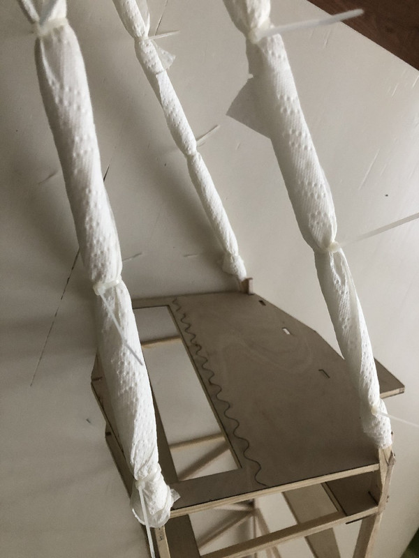

Now I that have something "I can touch" in hand, it's nice to focus on some smaller things like the "glove compartments".
Having issues bending the front longerons over the plan, I came up with this:
I know; it looks far from professional, but it seems to work. Using kitchen towel and draining this with hot water every few minutes makes that front becomes weak and bendable as were the aft section stays dry. I'm pretty sure there is an easier or more logical way for doing this, but none I've learned so far :oops:
Bending over the plan:
This turned out to be not as easy as I imagined. Next time I will have to build a ramp or some thing to keep the whole structure in place, to make sure everything lines up!
As said, bending was a lot harder than I imagined. The glue on the upper parts came loose duets the moisture. Good thing is that they will fit eagerly back in to place later on.
Well, now I can bend them over the plan and hopefully get them to fit straight again once dry. I did make little saw cuts on the inside to remove material and allow for a tighter bend. Before the actual bending I filled the saw cuts with glue.

These days, where possible, I would laminate two 3 x 6 mm strips together to get an easier bend...

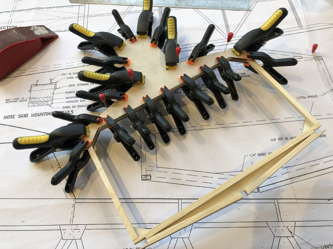

Preparations for the skid are underway;
I'm not too sure yet on how to tackle this; The four layers of ply (drying here, but not glued yet) are okay and still give some flexibility. Though gluing them with epoxy and adding carbon strips seems a bit rude, as all the epoxy I'm used to gets rock hard. The way I understand skids is that they are supposed to have some flex, or is this only for full size gliders? Any thoughts are welcome!
Backspine preps:
And the whole serie done:
These will be glued to the inner sides of the frame, instead to on top of it.

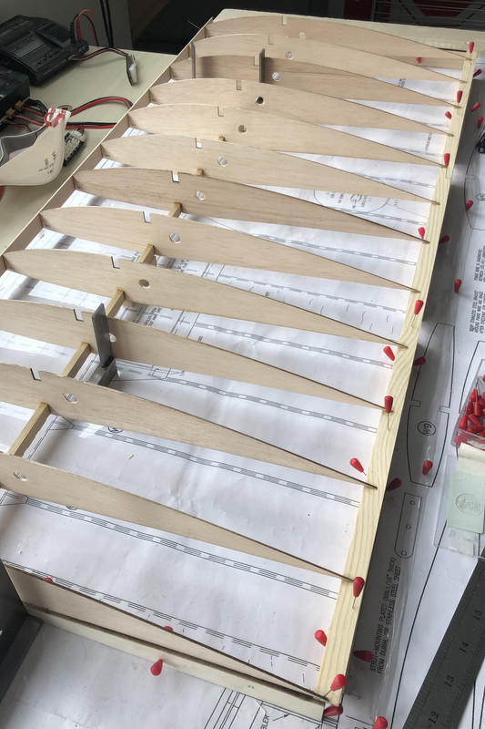

Horizontal stabiliser section is as good as done;
This thing is quit big! Joining these two pieces I say there was a bit of room left which I filled with pva and sawdust.

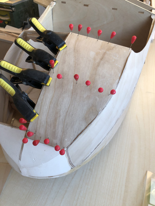

Time for some more sheet work:
I'm not sure how else to hold the sheet in place than using pins. These pins are made for balsa, so I keep breaking them while forcing them into the ply.
Starts to look like a glider now :P :
https://i.postimg.cc/k4V4rdR0/DObers_Sedbergh_0050.jpg
More to follow..

For the first couple of flights I'm planning on having the Sedbergh towed, though I plan on flying it on the slopes. Anyways, I'm building in a tow release.
Since this is my first real build, it is also the first time I've put one of these into a glider.
There the belly of the T-21 is rather flat, the easiest way would be to put straight into the nose, though I do not like the looks of it..
The fix the installation I mixed so fiber with epoxy. There whole thing is rock hard, so hopefully strong enough..
Now I'm left wondering if the ff needs more structural strenghtening? Looking at builds of the 1/3d version, I see a whole lot more wood goes into the nose..

I started the right wing, skipping the first rib as per guidance. This to allow alignment of the joiner box later;
Good thing I did not start gluing straight away since I figured quit late i needed holes for wiring.
I experimented on how to make these holes the easiest and neatest. Seems it is close to impossible to dril bigger holes in balsa sheet. Since I did not have a hole puncher I made one out of heating pipe. This still was not perfect, so I put the copper selfmade puncher in a drill, and it worked out quit nice.
WIP:

Not sure on the easiest way to bend the sprue trailing edge of the aileron; I pipped it in my koi pond over night :D
It turned out to be flexible enough for bending the next day;
As per plan, the aileron is glued to the wing to allow sanding afterward;
Running short of construction material, I cut the leading edge out of a 25mm balsa plank. Guess I'll be doing some sanding later on :lol:

Man, why do I do things so complicated :oops: I just finished these, wondering about the best approach..
First I bend some test strips:
Which later turned out to these:
I did reenforce both with a carbon strip, but now I'm considering to make new ones as yes, they look stronger made out of one piece! :D
Thanks a lot!!
