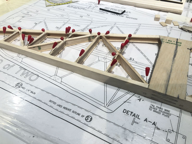

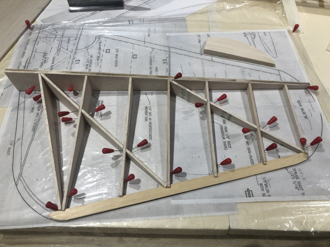

Starting with the tail section, here ribs 2 and 4 seem somewhat short:
And while stuff is drying I started on the rudder too:
Next time I think I will as a small ramp (is that correct English?) instead of building these curved parts on the plan. Haven't always figured out what the best technique for building straight..

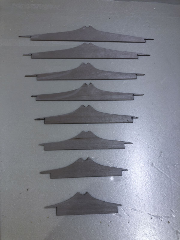

Preparations for the skid are underway;

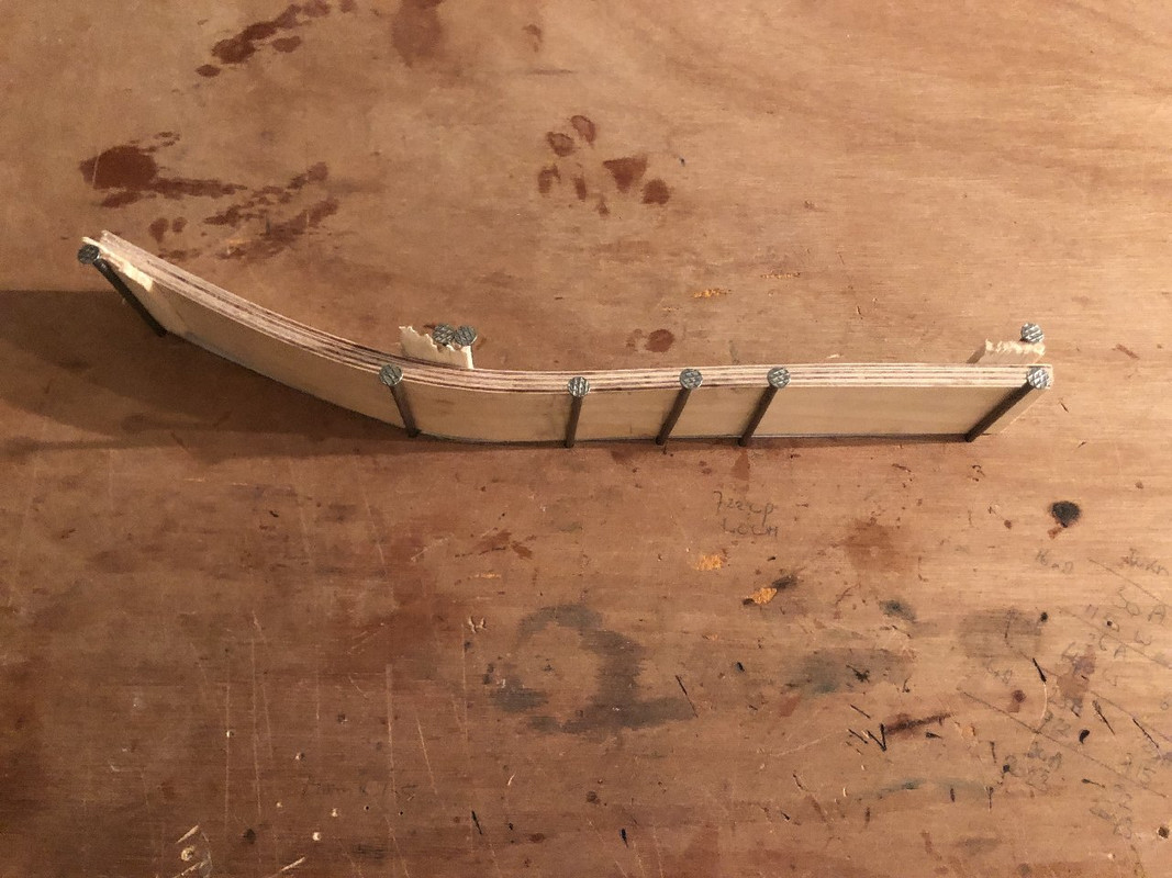

I'm not too sure yet on how to tackle this; The four layers of ply (drying here, but not glued yet) are okay and still give some flexibility. Though gluing them with epoxy and adding carbon strips seems a bit rude, as all the epoxy I'm used to gets rock hard. The way I understand skids is that they are supposed to have some flex, or is this only for full size gliders? Any thoughts are welcome!
Backspine preps:
And the whole serie done:
These will be glued to the inner sides of the frame, instead to on top of it.

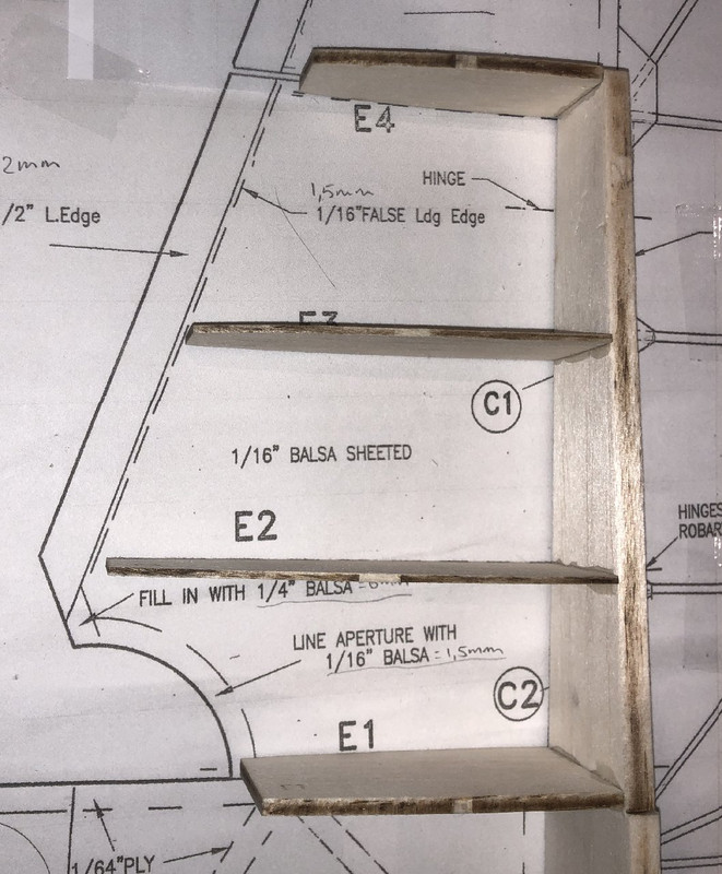

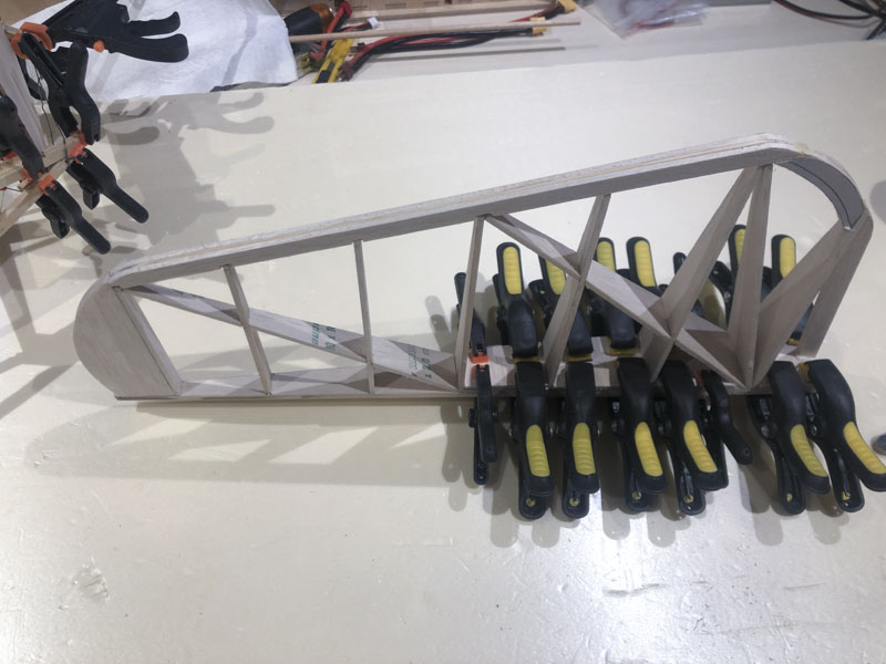

Eventhough trying to keep the aft as light as possible, I felt the need for some extra meet on the rudder as the balsa base seems to be to soft for holding hinges. So, on the critical spots I added a small layer of ply:
And the whole rudder done:
Backspine preps:

On my laminated skids, I always use PVA glue as it remains flexible. I have never had one fail by delamination so can commend the option as being well tried and tested.

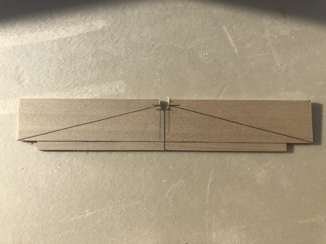

Simple side question; did someone ever made successful use of one of these?:
For some reason it seems impossible to cut longer straight strips with this simple tool..

I find that the balsa stripper seems to work better if you use a new blade and angle the blade as much as possible so that the tip end cuts much later than the top part

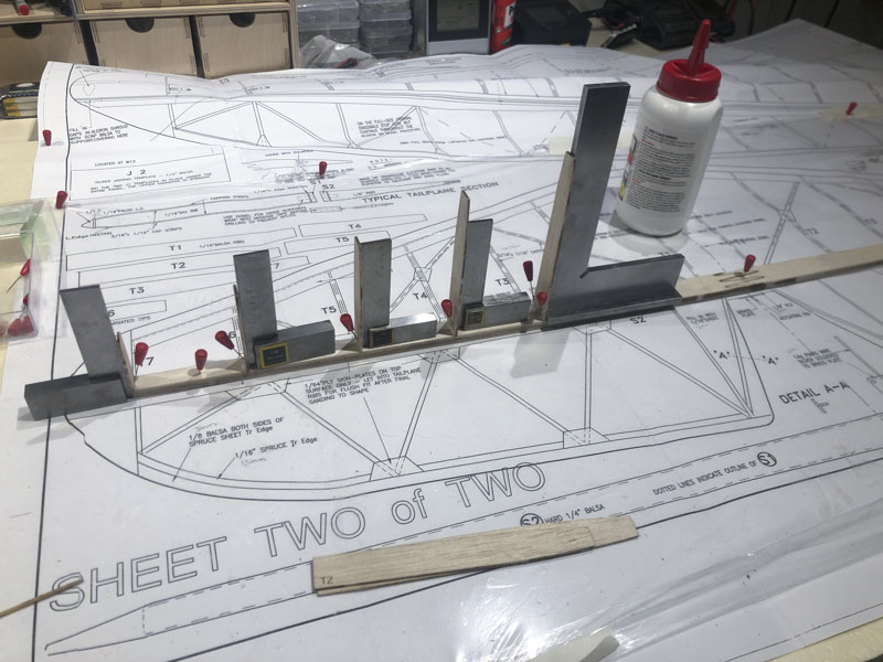

Here some more progress:
Sorry, I did not setup a boot for taking pics

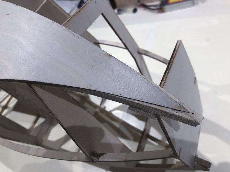

Now with the sidepannels mounted it somewhat starts to feel like something more solid!

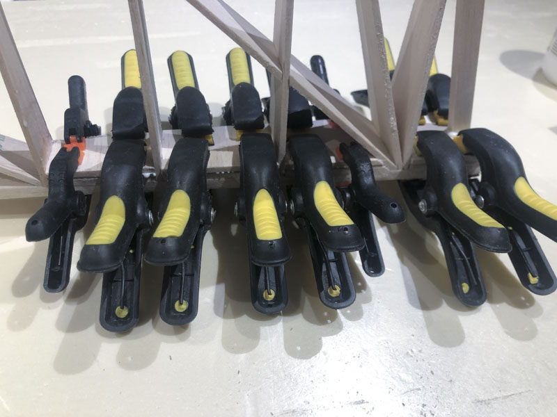

I found this the easiest way the get the ribs glued in straight. It must be said that the trailing edge is of very soft balsa. I might reenforce, but will have to seen what the whole structure will feel like once completed.
